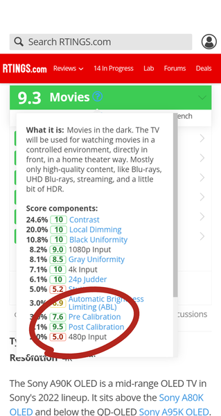

Mettici quindi le mani, o faccele mettere:
https://www.rtings.com/tv/reviews/sony/a90k-oled
