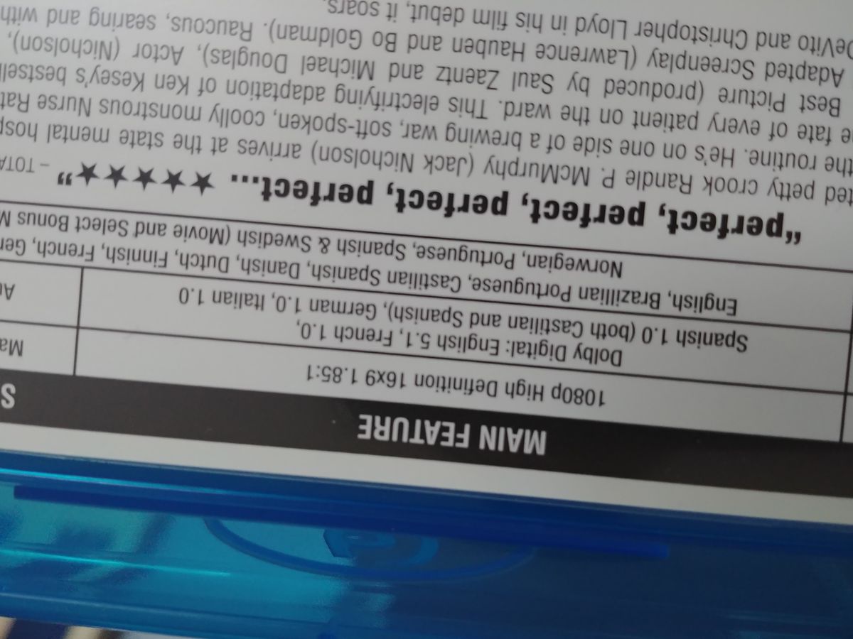

Yes I tried all those settings and still only get 'Dolby Stereo Digital' on the Dolby Digital 5.1 blu-rays. Of course DTS surround sounds comes through fine with the DTS Dolby Digital 5.1 enabled Blu-rays. I will upload pictures of the audio information on back of the blu-rays boxes and the audio being passed through. You can see 'One Flew Over the Cuckoo's Nest' is standard DD 5.1 but outputs in Dolby Stereo Digital but Moon outputs in the correct DTS surround sound, thanks in advance

I added the pictures below but for some reason it turns the images upside down anyway I hope you can make it out

Box shows DD 5.1.Box shows DD 5.1.Output is only Digital Dolby StereoOutput is only Digital Dolby StereoOutput says DTS 5.1.Output says DTS 5.1.output is DTS Surround Soundoutput is DTS Surround Sound
