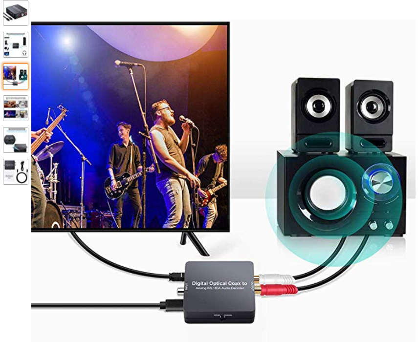

I got this one, it's Optical to Stereo, unfortunately this is the one I ordered for now
But Probably I should try this then
rooobb
I did not understand what is the actual setup you want to create...
Those devices only split the digital signal coming from the tv into analogue, than you'll need in any case an amplifier to drive your speaker and this will be the one who will control the volume. None of those devices will receive or change the volume. AFAIK

Though there, the surround system did at least have Optical In. For surround, you will need a gizmo like the HDMI to HDMI device you pictured, but with Optical to 5.1 RCAs, instead of the Optical to stereo (2.0) in your first picture. But if you get it working in stereo with the device you have, this will be a good proof of concept, and then you can maybe hunt down a 5.1 splitter, like this one:-

1- I was able to get stereo sound using Optical output with the small optical/Analogue 2.0 device I got
2- as you mentioned whether I choose audio system or TV speakers, the optical will always output sound, so I did think of using the dummy jack in the headphones
3- I heard and read a lot about the Fixed/Variable headphone and how it affects the optical output, but very strangely I could not find this setting anywhere in my AF9, maybe they removed this setting from the latest software, or maybe I am searching in the wrong place
4- I wanted to get what you suggested, but then I found this, and unfortunately I have to use this as I am not able to find the variable headphone settings
