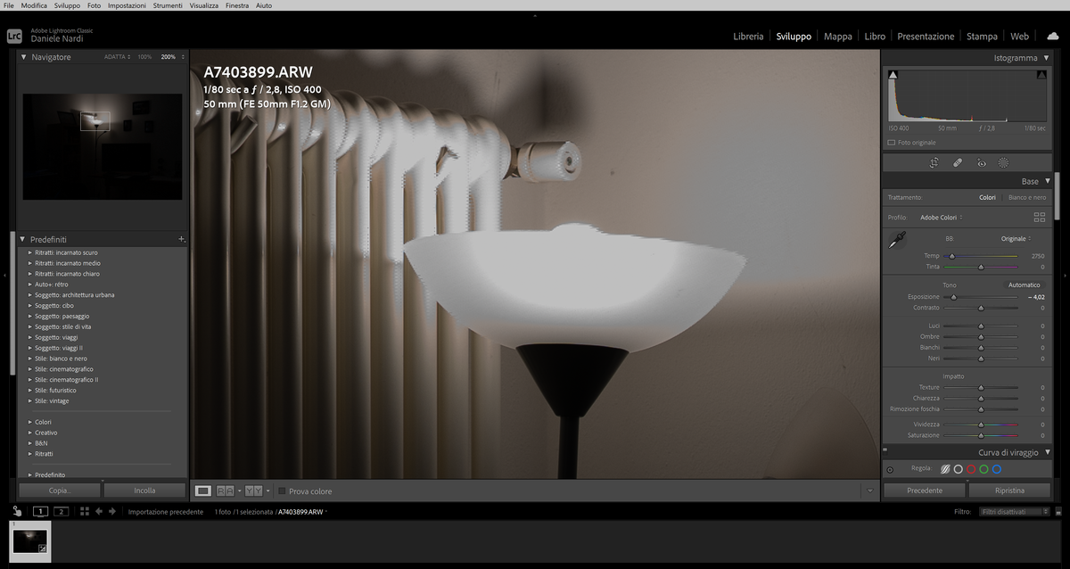

Lightroom:
Lightroom Catalog-v11 - Adobe Photoshop Lightroom Classic - Sviluppo 07_04_2022 10_58_40.png

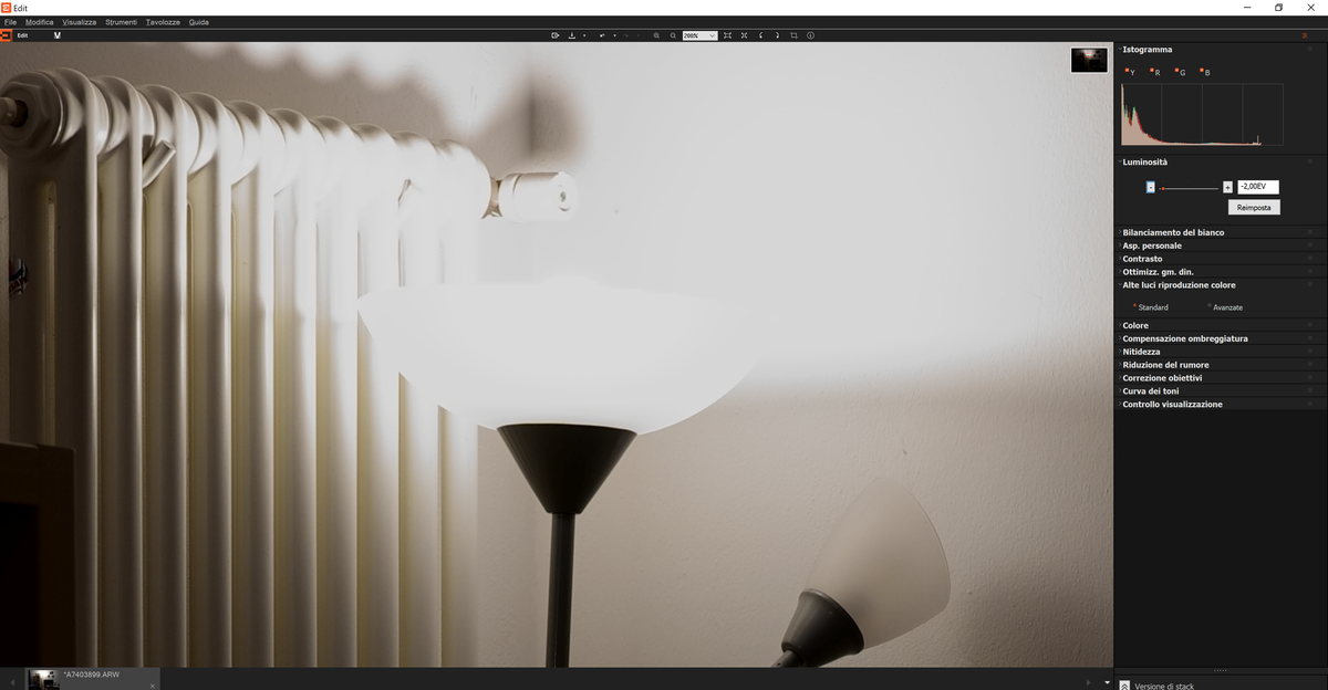

IEE:
