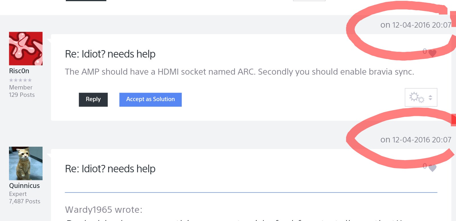

@Risc0n - look at this for timing!
profile.country.GB.title
Risc0n
Contributor
Haha!
